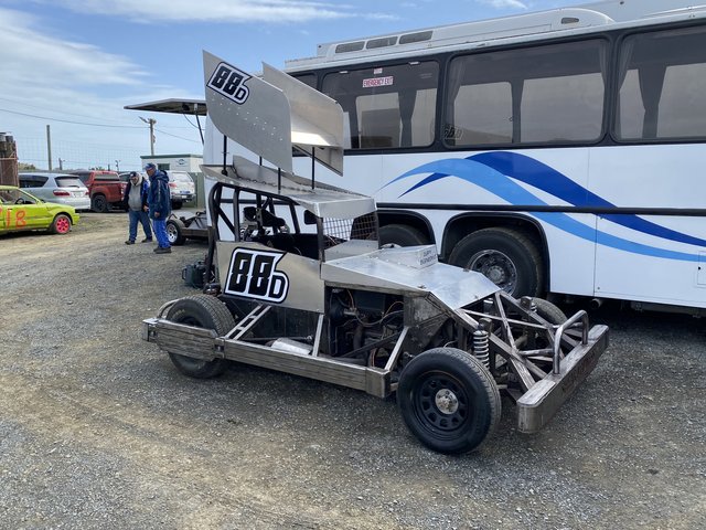

Post by mrdamage on Oct 19, 2020 12:05:42 GMT 12
Small Bump, Sold the car couple of at the end of the 2018/19 season, Zaneo bought the car running out of Dunedin, modified it to make it his own - stepped up from Streetstocks. Entered both the NZ Champs & GP last season, unfortunately got rolled at the coast but came to grips with the car pretty quickly Now sporting the Nude look Panels. - Which suited me fine, got to chop up the sides and donate them to sponsors and hang in my shed! He's done a heap more to the car this offseason;  At the tail end of the 2017/18 Season I sold a project car, and had a hankering for a Tank, and came to a deal for Dave Evan's Tank #4. Which was languishing in paddock. It then sat in my shed until the the of the 2018/19 season before I commenced a massive rebuild with the help of KP himself.. www.facebook.com/TankIIII
